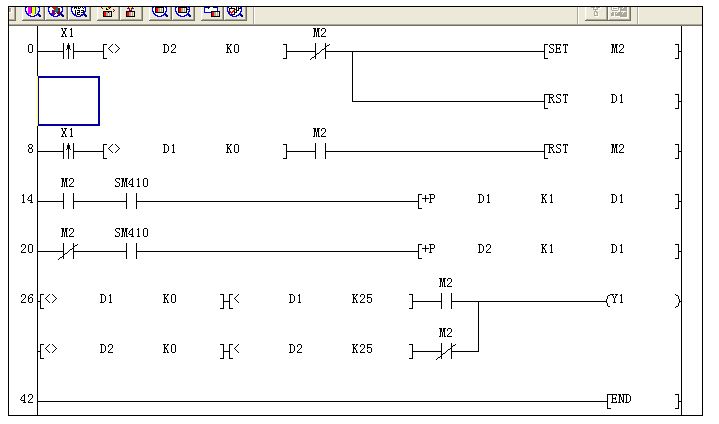

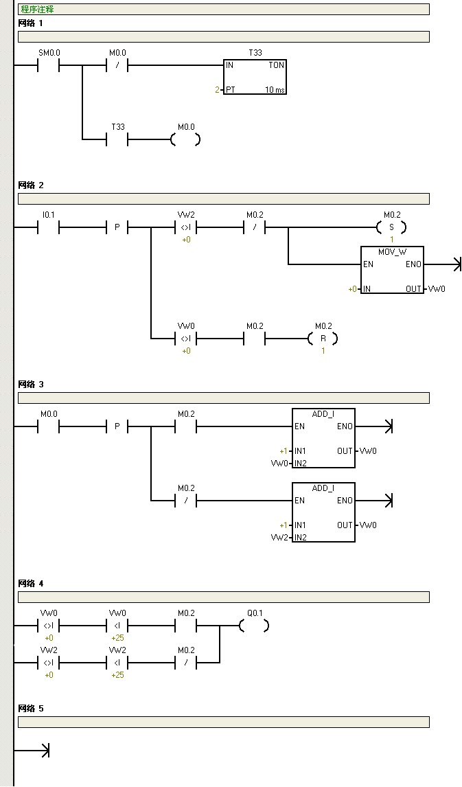

能转换的师傅门帮我转下 谢谢了

    A(
      A     I      1.1
      BLD   100
      FP    M      0.0
      A(
      L     MW     2
      L     0
      <>I
      =     L      0.0
      A     L      0.0
      AN    M      2.0
      S     M      2.0
      A     L      0.0
      A     M      2.0
      JNB   _001
      L     0
      T     MW     2
_001: NOP   0
   A     M      2.0
      JNB   _002
      L     MW     2
      L     1
      *I
      T     MW     2
_002: NOP   0
   AN    M      2.0
      JNB   _003
      L     MW     4
      L     1
      *I
      T     MW     4
_003: NOP   0
   A(
      L     MW     2
      L     0
      <>I
      A(
      L     MW     2
      L     25
      <=I
      A     M      2.0
      O
      A(
      L     MW     4
      L     0
      <>I
      A(
      L     MW     4
      L     25
      <=I
      AN    M      2.0
      =     Q      2.0

SM410是 什么意思 还有+p是什么指令 这些以前没有见过 谢谢
