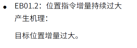

汇川SV630N驱动器一上使能就报Eb01.2

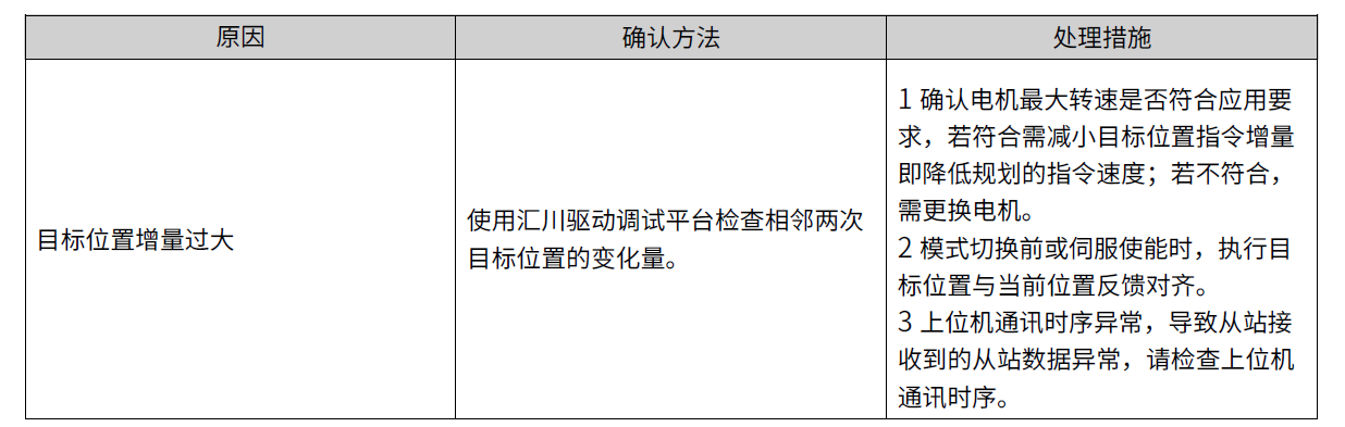

汇川SV630N驱动器报错
