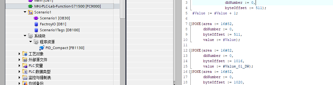

导入MHJ-PLC-Lab-Function-S71500.scl自己建立的 factory io TIA Portia 仿真模板用不了???有自己建立成功的吗??
FUNCTION "MHJ-PLC-Lab-Function-S71500" : Void
{ S7_Optimized_Access := 'TRUE' }
VERSION : 0.1
   VAR_TEMP
      Value : Byte;
      ForCounter : Int;
   END_VAR
   VAR CONSTANT
      Value_01_DW : DWord := 16#1223_5486;
      Value_02_DW : DWord := 16#A6C9_D1F5;
   END_VAR
BEGIN
    #Value:=PEEK(area := 16#82,
         dbNumber := 0,
         byteOffset := 511);
    #Value := #Value + 1;
    POKE(area := 16#82,
         dbNumber := 0,
         byteOffset := 511,
         value := #Value);
    POKE(area := 16#82,
         dbNumber := 0,
         byteOffset := 1016,
         value := #Value_01_DW);
    POKE(area := 16#82,
         dbNumber := 0,
         byteOffset := 1020,
         value := #Value_02_DW);
    FOR #ForCounter := 0 TO 63 DO
        #Value:=PEEK(area := 16#1,
             dbNumber := 0,
             byteOffset := #ForCounter);
        POKE(area := 16#81,
             dbNumber := 0,
             byteOffset := #ForCounter,
             value := #Value);
    END_FOR;
    #Value := PEEK(area := 16#1,
                   dbNumber := 0,
                   byteOffset := 512);
    POKE(area := 16#82,
         dbNumber := 0,
         byteOffset := 512,
         value := #Value);
END_FUNCTION

1楼  发表于: 2022-02-11 16:30
有大师吗
