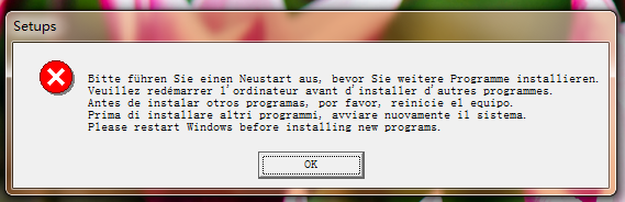

Ϊʲô64λwin7ϵͳװSTEP7 V5.5³öÏÖÒÔÏÂÇé¿ö£¿

[img]

ÔÚÔËÐÐÀïÊäÈë regedit½øÈë×¢²á±í£¬ÔÚ×¢²á±íÄÚ¡°HKEY_LOCAL_MACHINE\System\CurrentControlSet\Control\Session Manager\ ¡±ÖÐɾ³ý×¢²á±íÖµ
¡°PendingFileRenameOperations¡±
ÊÔÊÔÕâ¸ö
