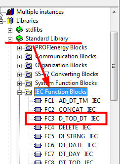

发表于: 2012-04-23 09:01
Standard Library------IEC Function blocks----------FC3(D_TOD_DT)
Good Luck~
